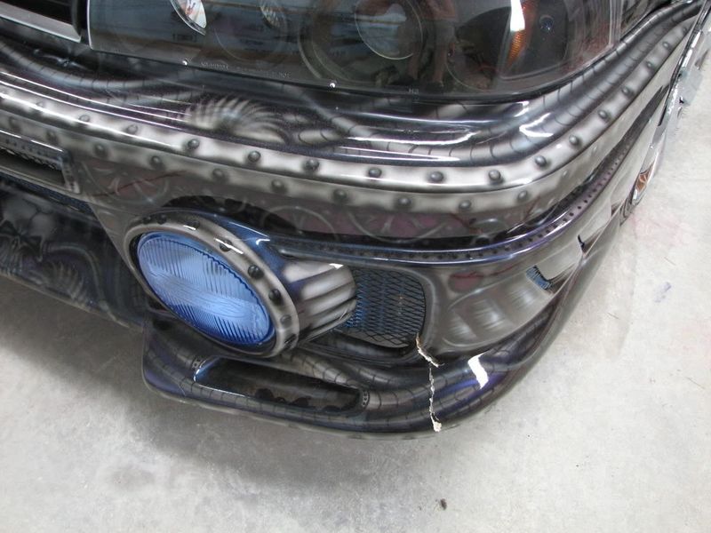

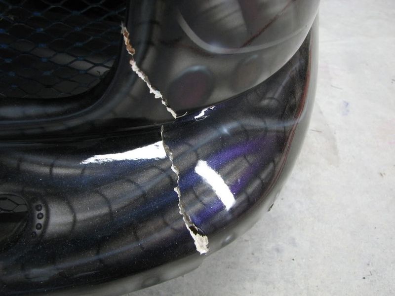

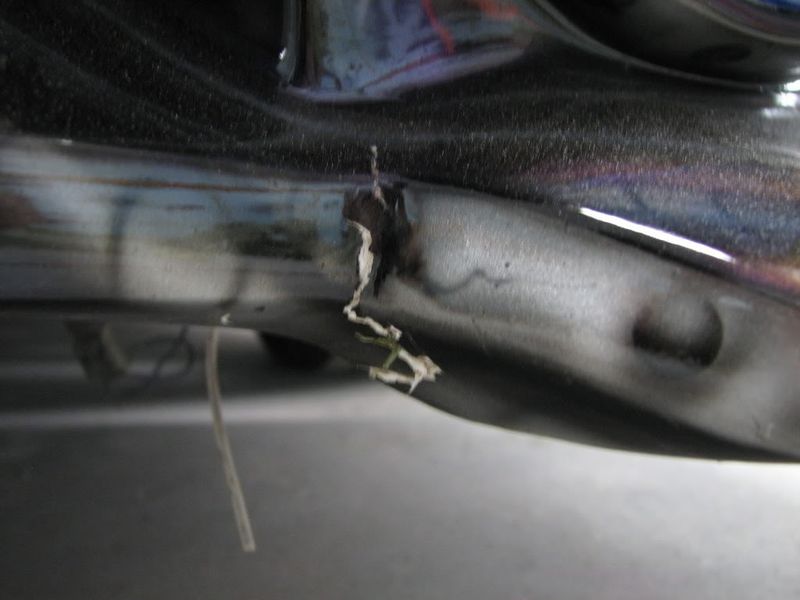

It's funny because I forgot to tell you the reason it was brought back this time was because the front bumper got smacked up and need to be re-glassed, and then the interior came along with it

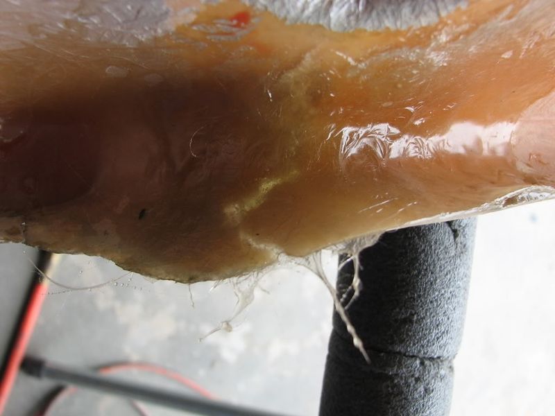

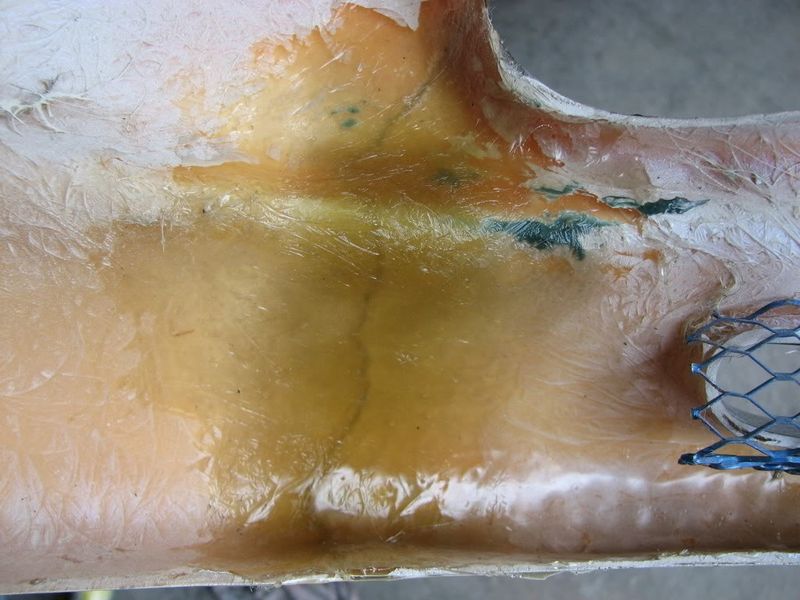

In this pic you can see where i had to reglass the back of the bumper for extra strength

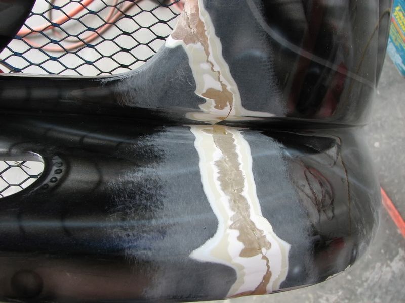

Then I ground out the remainder of the broken&cracked fiberglass from the front.........

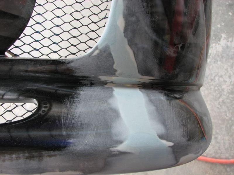

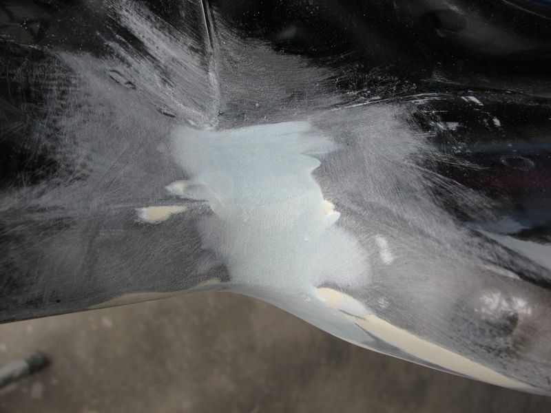

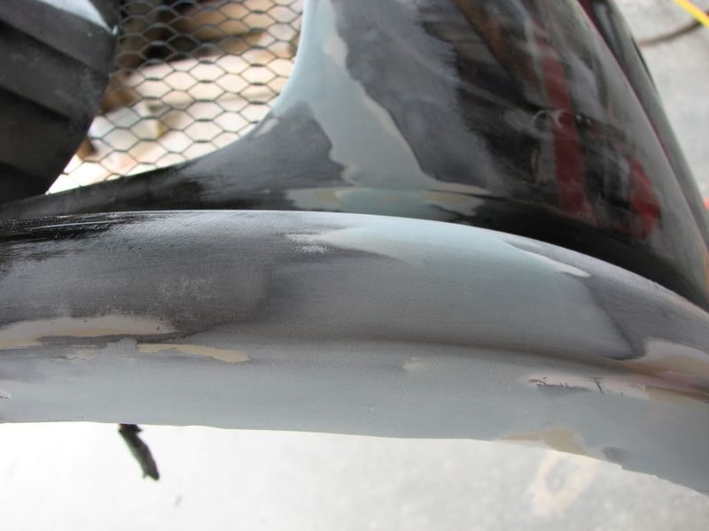

and after alittle bit of lovin/mud work she was as good as new lol

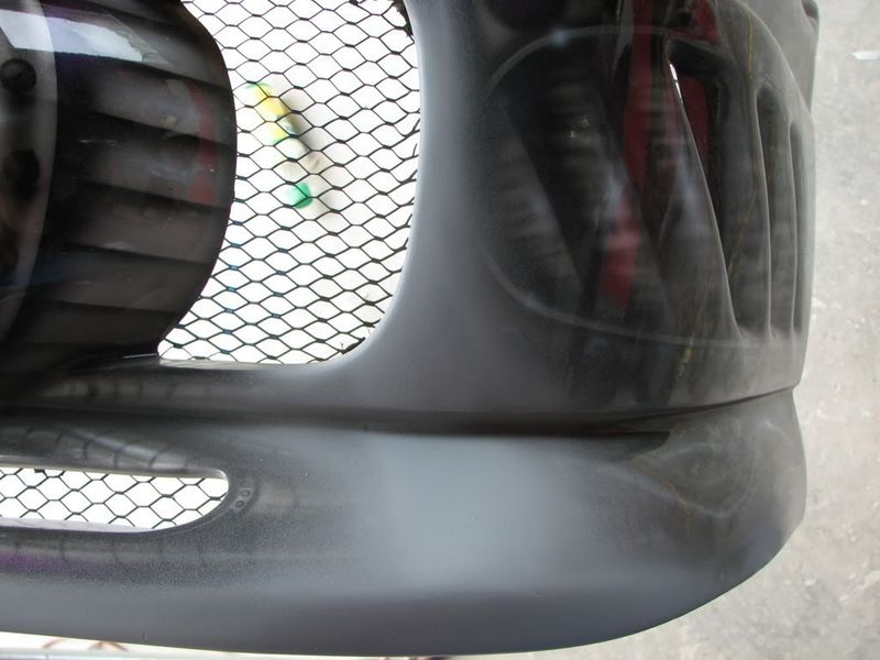

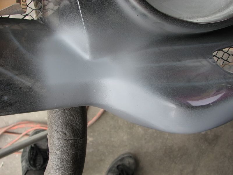

And finally it gets it's firts coat of primer........
^^^^^I'm still looking for the final paint pics but I can't find em
