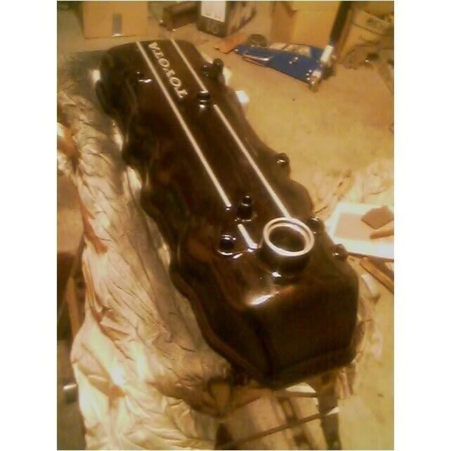

i blocked it and reprimed it last night. then sprayed numerous coats of gloss black rustoleom style paint onto it. today, i sanded the ribs and toyota back to metal. then decided to dig through my oil caps, found a cool one, prepped it and sprayed it silver. figured it would go well with the ribs. and i also blacked out the little spark plug hold down tabs that go off the side of it.
another little thing i got workin on was my a/c tensioner pulley. it was the stock serpentine tensioner from a 94 crown vic, and i took a smog pulley from a dodge smog pump i yanked and put that onto there. im going to modify the brackets that held my old smog pump to hold that so i can stick an a/c belt back on. it was crank/ac/smog and crank/water pump/alt for the 2 belt circuits. i took off my smog pump and emissions crap, so i lost the a/c. i painted the tensioner silver, the pulley bolt silver, and the pulley and washers black.

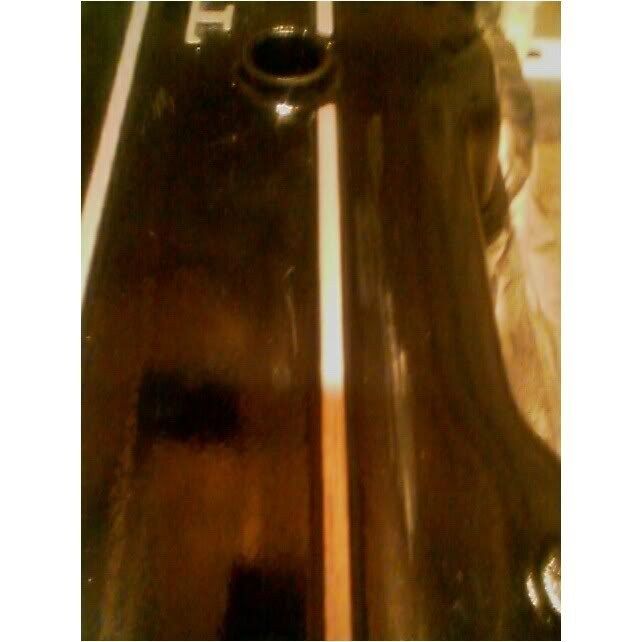

heres a few pics. im a bit uphappy how the valve cover came out, since i scratched it in a few places doing the ribs and toyota. im probably going to respray 2 more coats onto the black to fix it.
