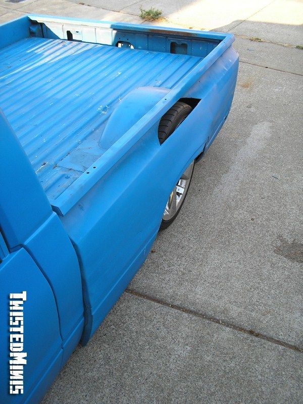

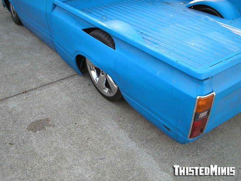

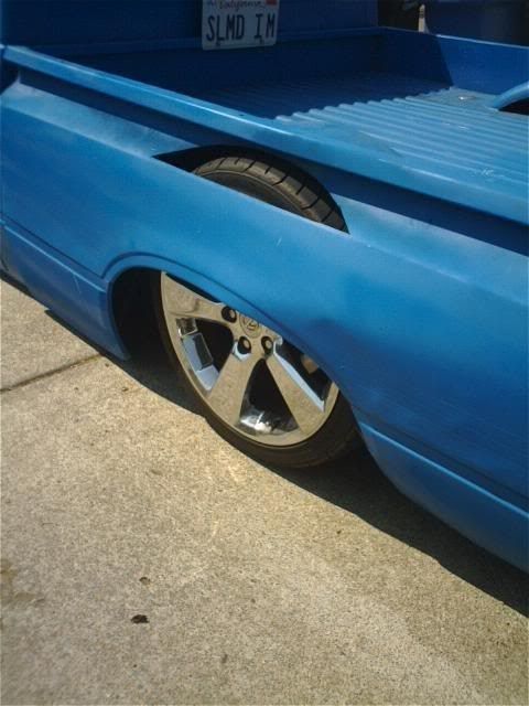

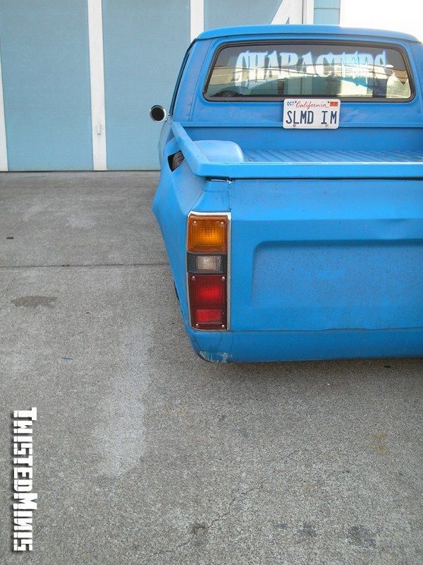

Okay I took some pictures.
TwistedMinis's avatar
TwistedMinis
Edited: 8/13/2008 9:04:39 PM by TwistedMinis
I took a closer look after dinner, and it looks like it just bent my two bedside supports, which are just 1.25 x .188 flat bar. I am going to cut them loose from the bed and see what it does. It bent the rear support inwards, and the front support outwards. I think the bedside is just twisted.
Pete says it can be fixed, I trust his judgement. I'll see what he says after I cut the supports, and go from there. I'd like to get it back into shape, then finish the metal work on the bed and give it to him to finish.
I know my way around shaping metal, but not so much with repairing damage.
