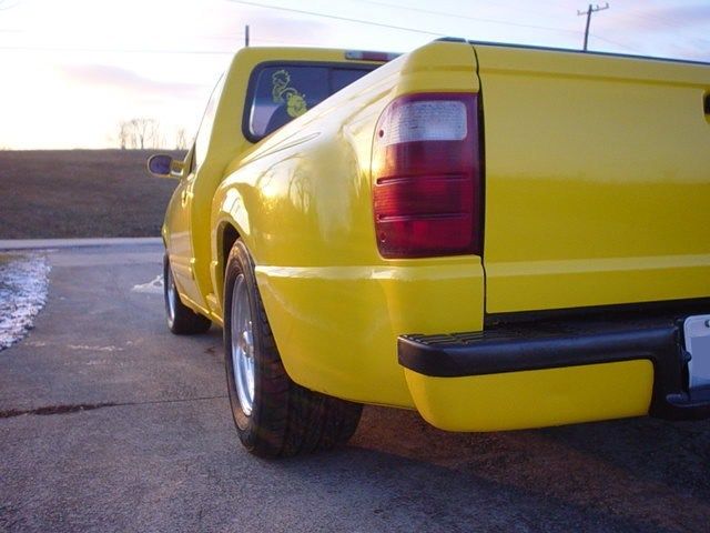

How sure are you about that? My truck is single stage with no clear coat. Sanded and buffed. Sanding and buffing won't leave a hazy or dull surface unless your burning the paint with the buffer, or using too high of a grit of sandpaper. The whole purpose of wetsanding and buffing is to make the surface smooth, uniform, and glossy. I don't care if it's flat black rattle can. If you sand and buff it enough, it's going start to shine. If you are getting dull spots then it's something you are doing wrong.
