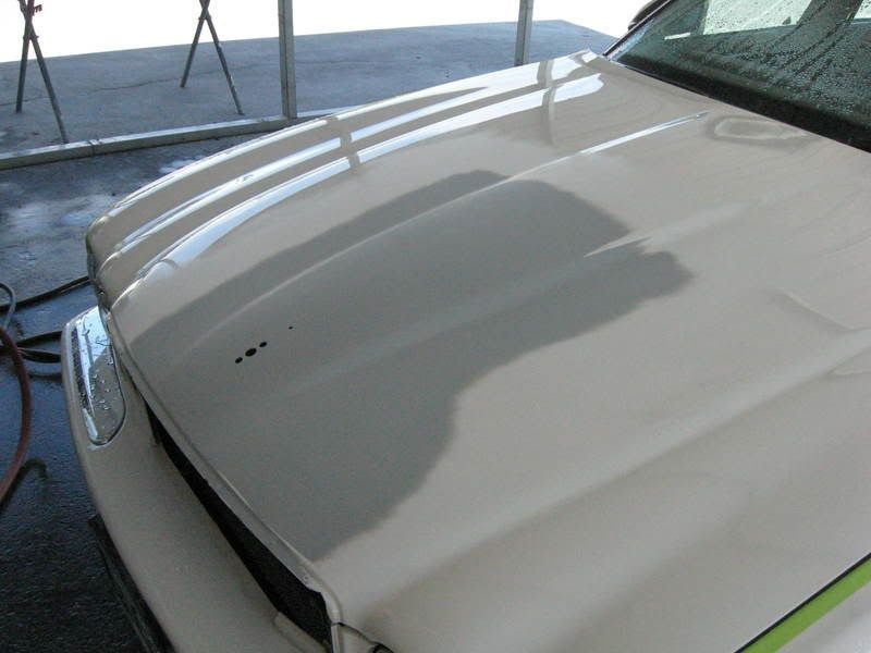

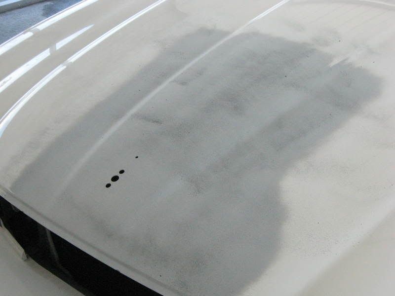

****This is how I do it at work every day. It may be different than other people's techniques, but it always produces great blends/adhesion this way. Different paint systems have different steps that may all produce a great end result****
After black sanding the primer down with 320 grit
Guide coat all the primered areas, this will ensure you refine all the 320 scratches down to the next level which is 500 for my application
This is after wetsanding with a foam block and 500 grit.

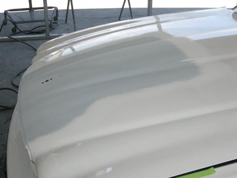

Then I use 1500 grit wet on the whole panel, this removes surface contaminants, some of the factory orange peel, and provides a good scratch for the paint/clear to bite to without being too agressive so that it will show sand scratches in the final product

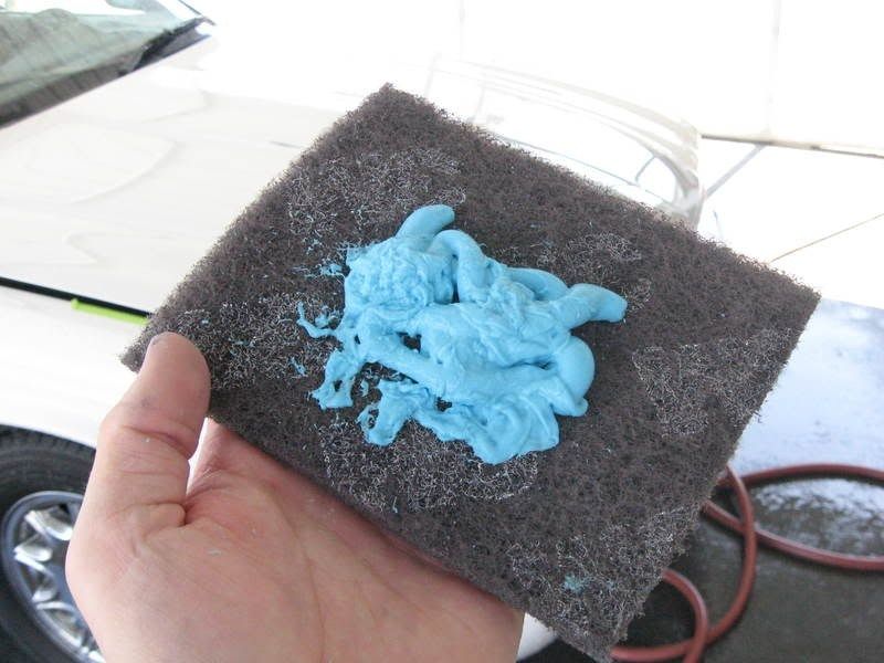

Then to get all the areas that you may have missed with the 1500 Scuff with grey Scotch brite. We use this sanding paste too, is makes the water want to dry up or get off the panel faster.
