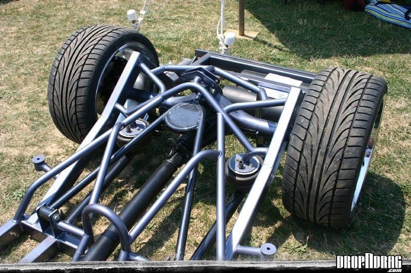

Something like this would work to. Its a little more involved than whats pictured above but works the same.

but so much nicer looking,those look bad ass

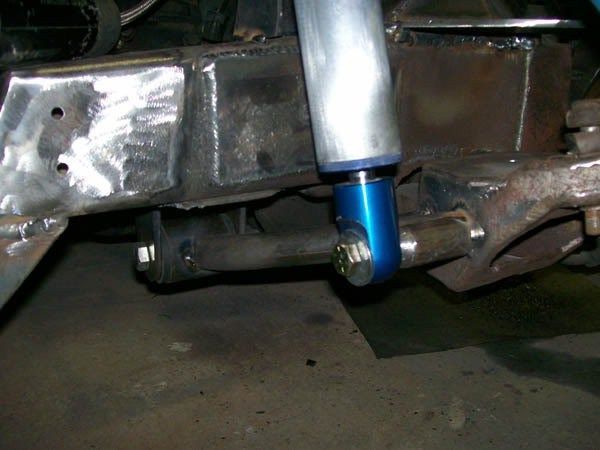

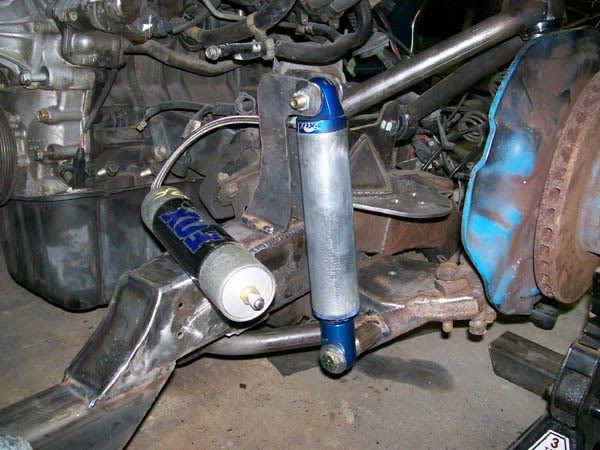

they do look good triagulated and all but with the tacos its not that easy to do. you would basically have to chop a majority of the front cradle off b/c the strut rods follow into the cradle. I still have mine, just repositioned where it connects to the lca. I set the lca at a medium then just welded the strut bar to it, that way it doesnt bind too much at full lift or aired out. I believe even the ones steve at cando sells are still in the same position just welded to the lca as well.

yeah, mine does too. and it works just fine with less work

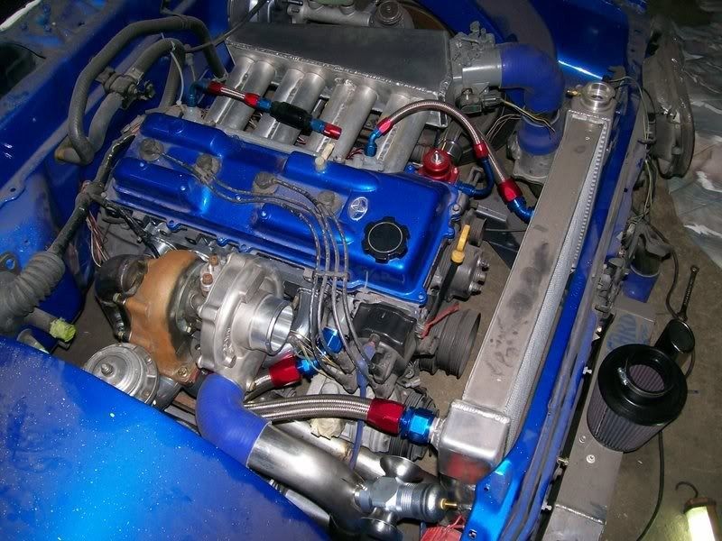

ya its painted now. working buttoning up the motor & interior. think he's gonna run 16 psi, hoping for 300rwhp. should be pretty sick.

i'll tell him its pretty cool that he made his own intake manifold, all turbo piping & header. the rest is 3/4 frame, all stainless hardline, stainelss braided for fuel & radiator, narrowed rear, *i think* 285/30/20 out back.
