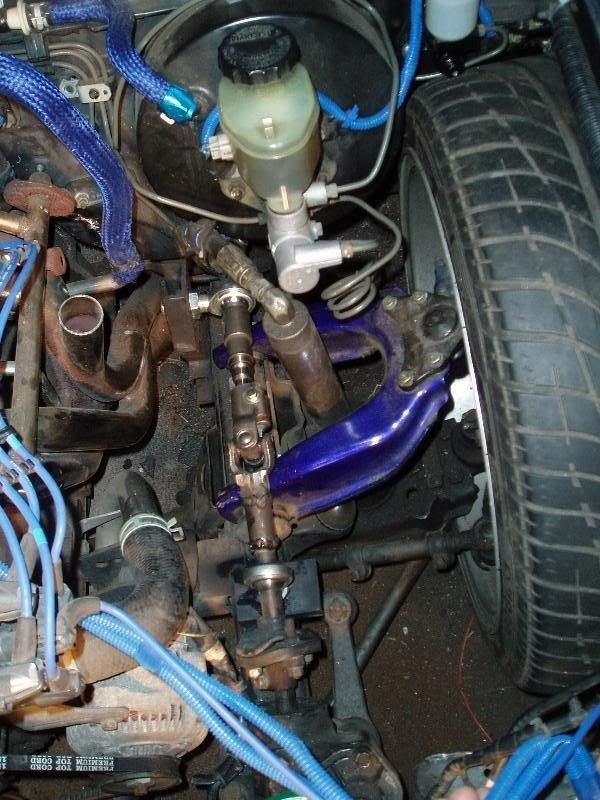

i would flip the ball joints in the front, worked great on my buddys yota when we done that
i tried but i have 15 inch wheels with reg spindes and i cant get the wheel on when i flip them.
waynehammer's avatar
waynehammer
Originally posted by TwistedMinis
Okay so your upper ball joint is binding. You should probably pie cut the arm to make it lay.
As far as the ball joint, you're out of luck there. I've looked, nothing really out there that is more low profile and the same taper. You would buy arms with a screw in ball joint, or build them yourself. Thats about the only way to get a lower profile grease cap.
so u think ill lay the extra 1/4 inch by pie cutting them.. i figured it would work but just wasnt sure
the501clique
i dont know if you can see it good in this picture, but there is a smaller ball joint than the one i see in your pics. ill try and find out the brand on mine but its about an inch and a half shorter than the tall ones you have.
waynehammer
I NEED SOMETHING LIKE THAT.. ILL SEARCH ALL THE BRANDS AT WORK AND SEE WHAT I COME UP WITH. THANKS
waynehammer
so i pie cut my arms today and it did the job. i can actual put 3 inch blocks under my wheels and still lay door..
