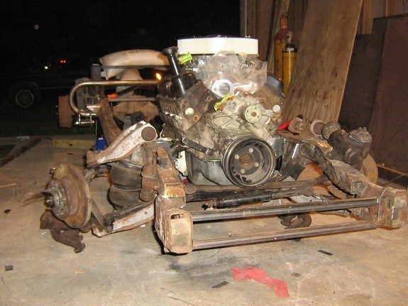

looking back on it, the rear sump would probably work better than the dual sump... my ranger has a 89 toyota clip in it with a 302 double sump pan. i pushed it real far back so that the steering is in between the crank pulley and the oil pan.
layed out it the drainplug is about an inch or so from the ground.
not sure if this pic will help at all but its a 302 in between yota rails
