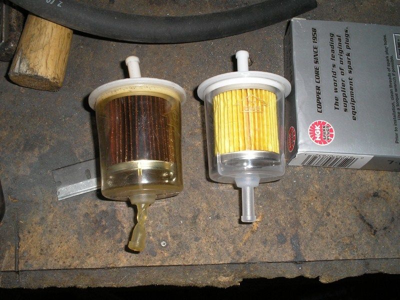

I replaced my fuel filter too, old one was nasty, but it made no difference either.And heres the black shit coming out of the pipe. The small dark patch is the freshest as I moved my truck back a foot.
