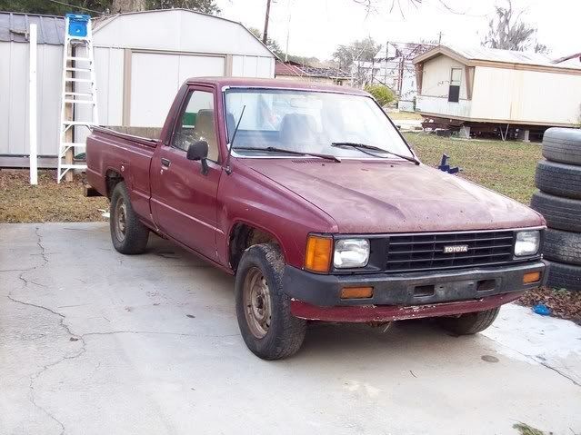

heres some pics of the 83 they of the cell phone so they small lucky ima send u a pm

You could save that. Mine was worse when I got it.
Lucky is correct, you will need to swap to newer spindles rotors hubs and calipers to run a drop spindle. If you don't they seem to have a ridiculous amount of camber. If I had to do it again I would put a 84-95 clip under it. Actually I am doing it again, and thats about what I am going to do.
