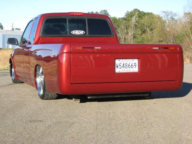

Here is a picture all finished up..

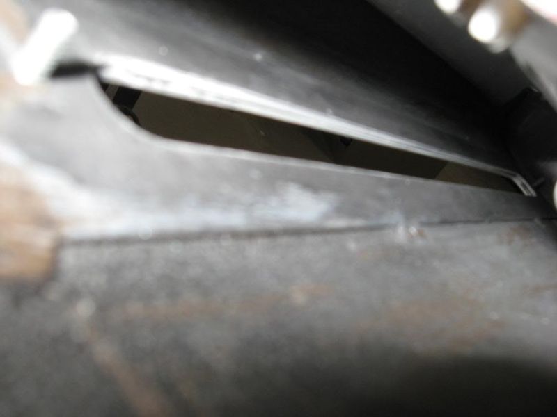

thanks for the info im goin to be starting mine soon..this may be a stupid question but how do u attach the light bucket behind the lens?
Joe here is you a pic of how the lights bolt up.
