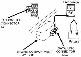

I am installing new aftermarket gauges in my 93 and I am having trouble with the tach wiring. it has pos and neg wires and then a wire for the neg side of the coil. 93's don't have a regular coil setup with positive and negative leads so does anybody know where this wire goes?

Hopefully this will help youIf you need anything else specific let me know

hook it up tp the green wire off the coil

thanks for the help
