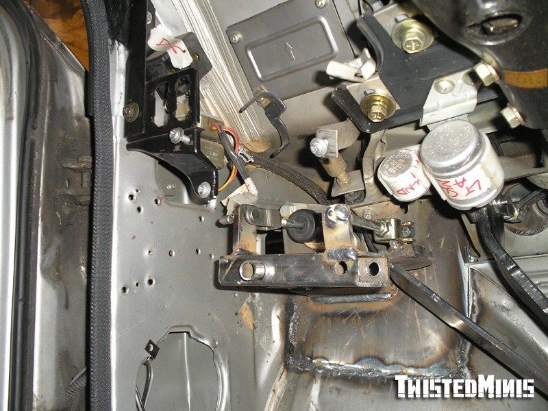

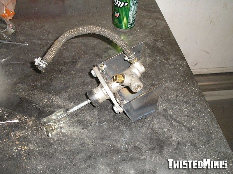

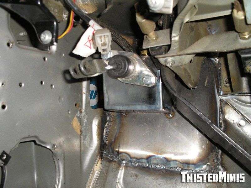

Bobbys idea works pretty well. I did it on the Nissan with a clutch master from a 90 Accord.

so then instead of using the resovoir, i can run a hose out to the brake master and run it off there? i mounted mine under the dash with the resovoir. where does it hook up to the brake master..??

I guess you could, but I don't really like the idea. I mounted a separate remote reservoir for the clutch on the firewall.
