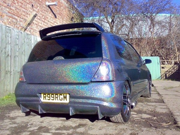

^^^Cool,Thanks for the advise. I should be getting my flake buster soon.....I can't wait to try it out!!!Does any one have pics of the work they did with the flake buster?? or just any pics with a flaked out paint job??...I'd love to see em'......... Thanks, "Lost Cause"
MysteriousGT1
i take it this is the rainbow flake!
coolpaintprofessor
that is rainbow flake , its to gay for me personally
