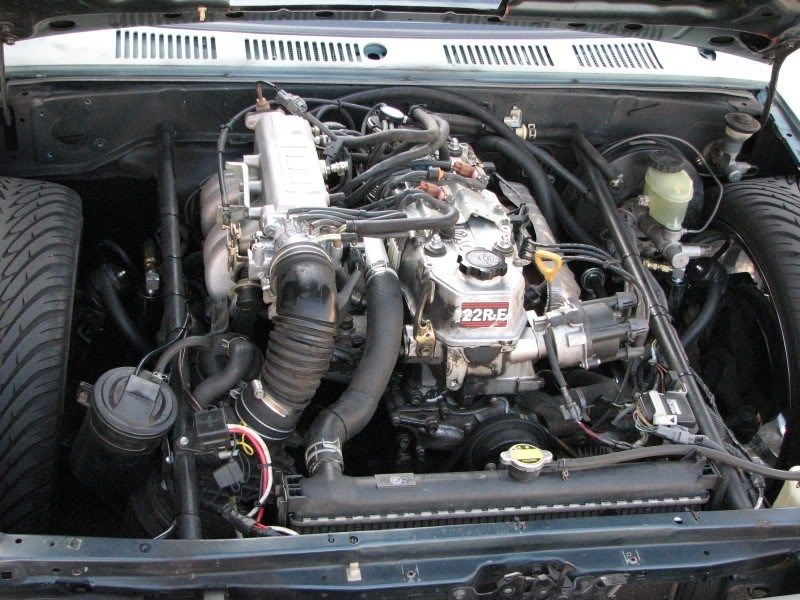

The best way to do it is reverse swing under the dash, but it wont be fun changing the fluid. Mine is raised up as you can barely see in this pic but the best one I have seen is Bobbys from Sadistic Iron. Also if you just have a body drop to the pinch you should just raise it, you should clear 18s and not as much work.
