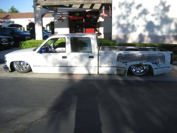

I found this one. Kinda hard to see with the shadows. But you can kinda see we just did one straight cut, then lifted the top about 4".

Yes, running all six 22s.... IMO my dually was wide enough, no way I wanted to make it wider, plus I think it looks "off".. with the unusually wider fenders, but thats just my taste. I like it to "look stock", but just hammered to the ground!
By looking at the pictures of those fenders, it was ALOT more man hours and headaches to do it that way then to just narrow your rear end....
ALSO... if youre not planning on body dropping it you will not have to raise them as high as i had to raise mine...
