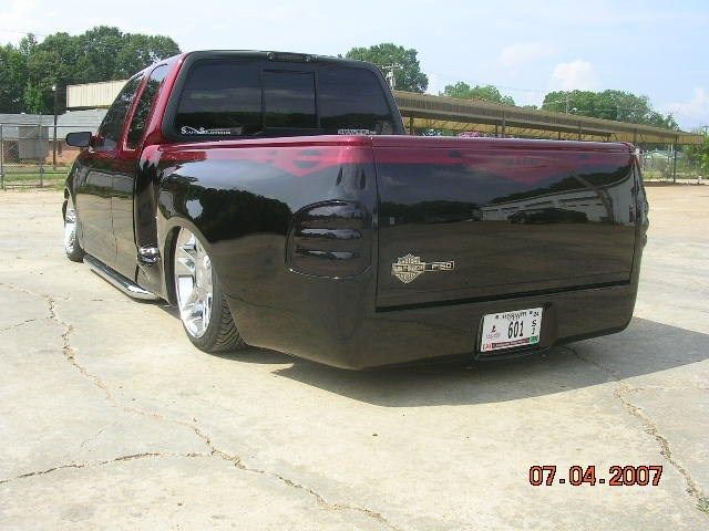

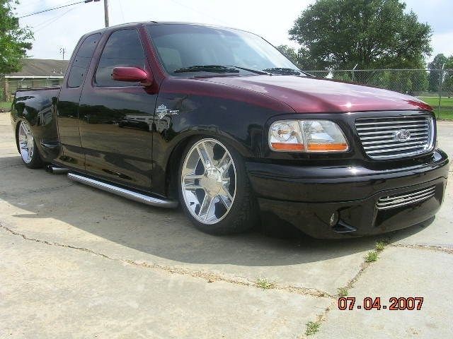

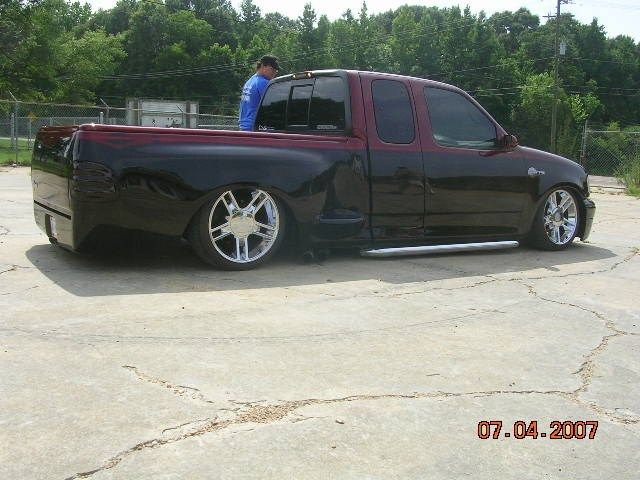

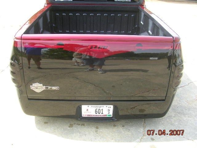

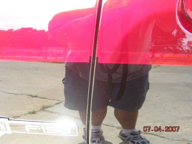

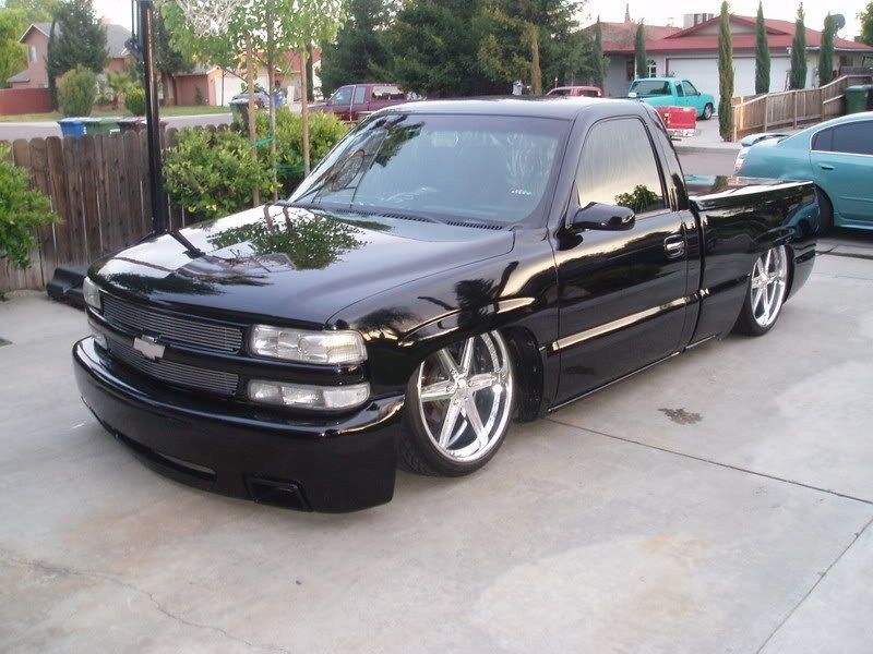

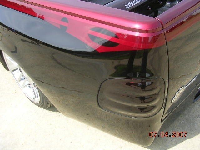

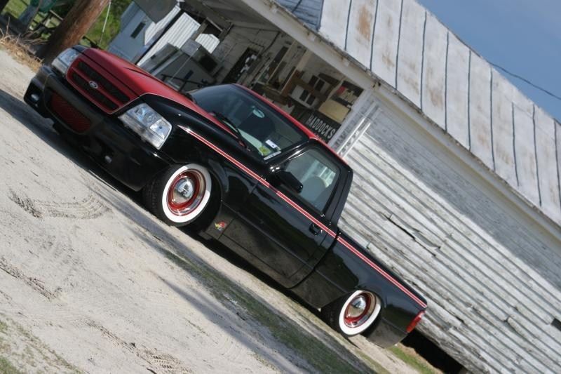

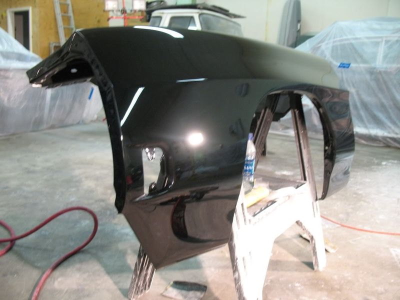

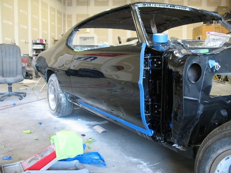

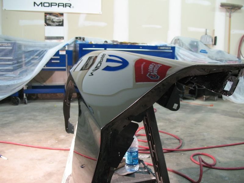

a couple ive done at the shop
post photo post photo post photo post photo post photo post photo post photo post photo post photo post photo post photo

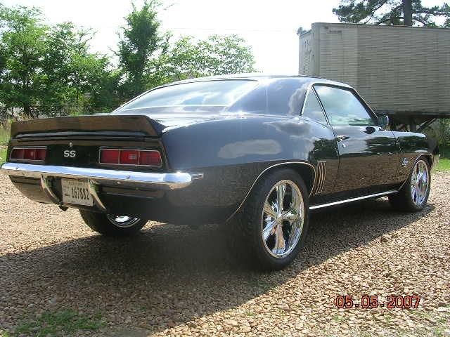

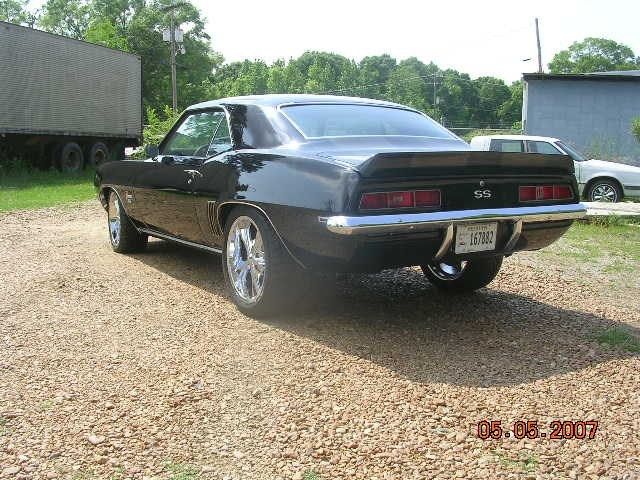

i also spray 5 coats, and i start with 600 grit on a 9" paint stick, i use the stick through 1500, the switch to a soft block up to 3000, then polish. how the hell do you post pics again?? its been a while!
http://i222.photobucket.com/albums/dd217/muff86/Picture042.jpg

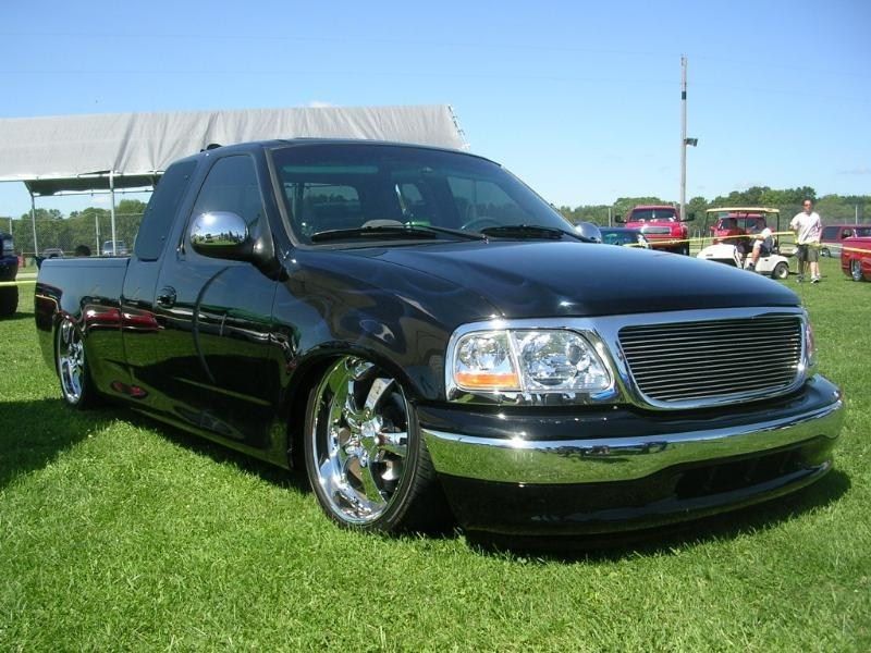

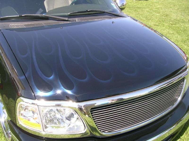

my buddys silverado he polished it alot and the last pic is his hood reflection.

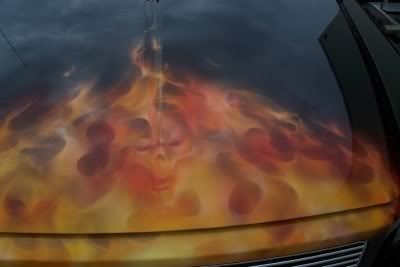

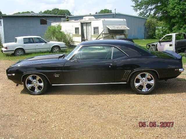

Here is a small shot of a hood we done at lanzinis last year. i dont have any better pics of it no more, sorry.
