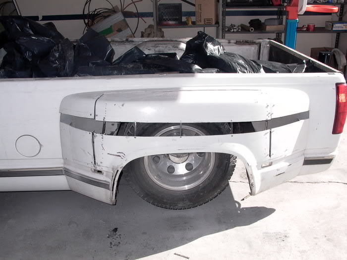

How do i make the fenders wider? That sounds easier than changing out the rearend.
E
ec_dually
alot of fiberglass, you will have to strecth them out close to 3 inches or more depending on your set up to make them clear when you lay out..
huskerdually
It's not a square but you can kinda get the idea.

I have the same problem except I do have the stretched rear fenders and still need to shorten my rear end by 3" (1.5" on either side). I'm not sure how much they were stretched. Turns out these damn wheels are getting expensive so I'm a little discouraged. What isn't mentioned in this thread is that you also need to cut down the firewall a little in the front or the 22"s will rub. Putting the 16" coupled with the 22" in the back is something somepeople do but like mentioned, you still have more work to do. Good luck and keep us posted on what you do. I am still weighing my options.
