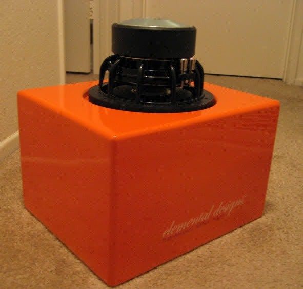

From what I've read, using light coats of primer works pretty good, I couldn't find a thread with step by step, but did find some real shiny/smooth MDF boxes.

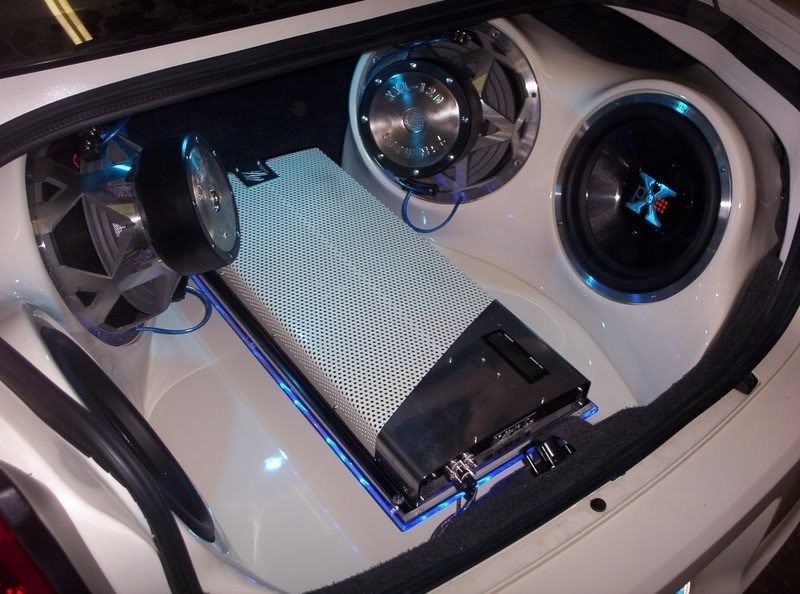

We Sand all the pieces smooth with 320 and the use a good urethane primer and block and sand it seal it and then paint. Try select products to by resign stay away from the elmers brand donesnt ever dry for shit for me. If you have to use BONDO brand fiberglass resign. Heres a pic of a charger we did the floor is a peice of 3/4 mdf. all we did was prime it and paint.
