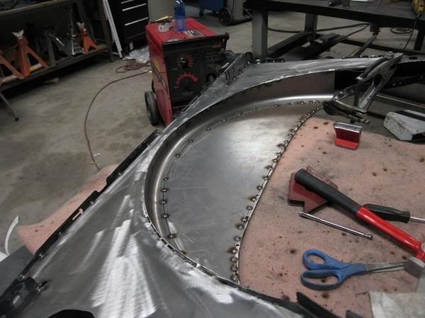

the fender more than likely has a lip that shoots out about 3/4 of an inch... go straight up with a peice of sheetmetal from the edge of that lip and meet up with the tub.. that way you dont have to weld or glue anything to the inside of the outside fender... probly didnt make much sense did it? this is what im talking about....this is how im doing mine right now...
p.s. thats not my truck.. just an example of how mine is being done and a suggestion maybe for yours... cheers!

that panel is looking pretty damn sick!!

that fender looks pretty much like mine are gonna. I just have the inner skin tacked in so far though.

HELL YEAH PASCAL THAT FENDER LOOKS REALLY GOOD NICE WORK
