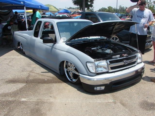

also, that taco with the 20's i posted has a narrowerd rear (possibly pre taco) and flared rears. but the front is stock suspension, so it will lay hard if done right.

Originally posted by framedragger
anymore pics of this truck? i have the same wheels...
granth
there is some from the STC coverage. If I ever get to the shop, I will get some if he doesn't mind.
