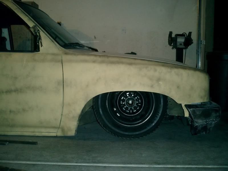

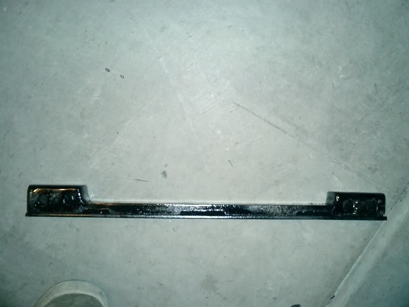

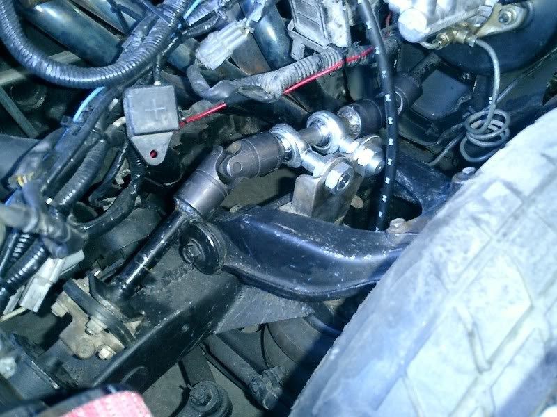

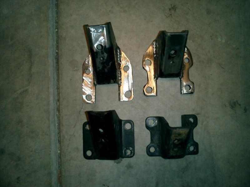

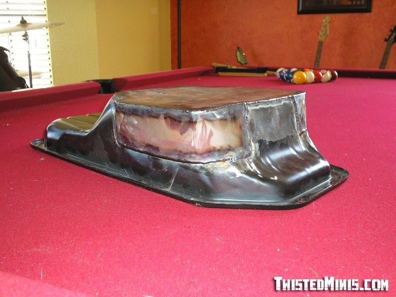

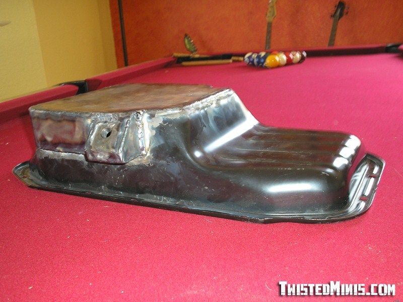

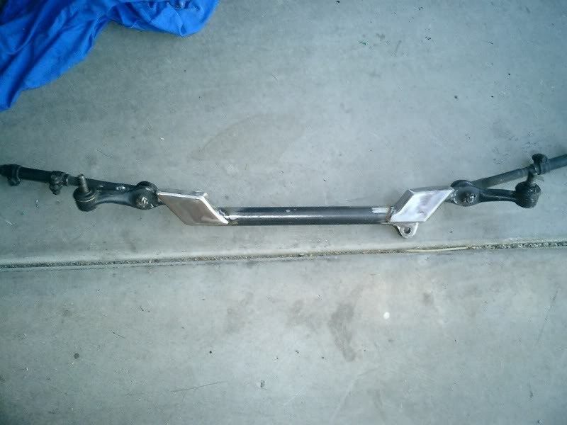

Originally posted by framescr8pintoy
mines a 91 with 22re... 3.5 bd with 1.25z to stock hood to fit..had too
motor mounts 1.5 "section oilpan..mod engine crossmembertrim a little of the support out from under the hood
also made a steering linkage.. got pics of all just too lazy to post at the moment.
If ya become unlazy and would like to post the pics..i wouldnt mind seeing em.
framescr8pintoy
Edited: 6/16/2007 10:33:51 AM by framescr8pintoy
before lowering motorafter lowering motor

Cool, thanks for the pics bro

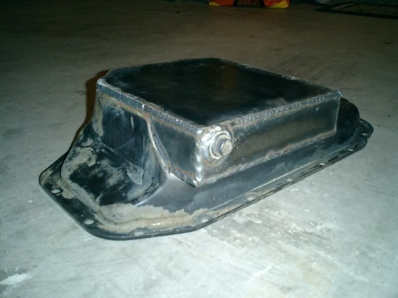

s10tukin22s
how much is that oil pan and where did you get it
framescr8pintoy
i made it
