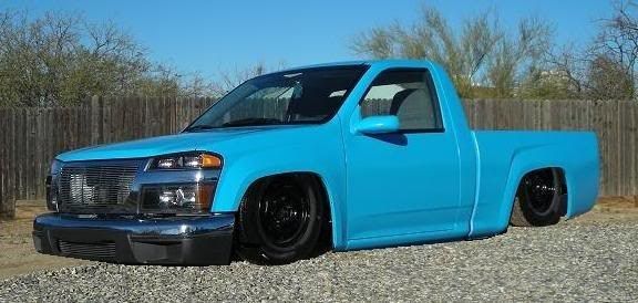

1SICKCANYON's avatar
1SICKCANYON
Heres my truck. It's just white sealer with blue base in it. I wanted something close to the color i was gonna be painting it in the future.
