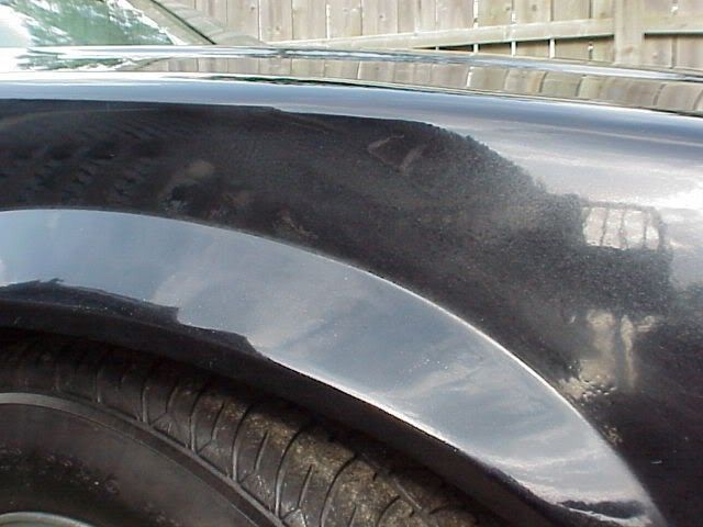

ok so i just finished the first enitial buff of this camaro i painted. its black with silver stripes. and there are cloudy spots, will they come out with more buffing? the clear i used is PPG concept DCU2042 low VOC speed clear

Can you take some pics of them or will they not show up in a picture?

your probably going to have to sand it and re-clear it. What happened probably is that the base coat is reacting to the clear and is disfusing the clear witch is causing the fog look.

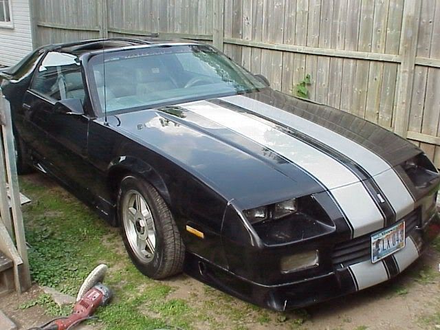

ok guys, heres a couple pictures. i hope buffing is all i need to keep doing cuz i dont have any clear hardener left. i only charged 2000 for the full paintjob including the materials and maaco painted 3 times before and i only had 3 weeks to knock it own to metal and build it back up from there.

there looks like a lot of pits in the clear
looks really thick... cant really tell if its burnt.. get some superfine pads and wetsand it again and then buff it out
