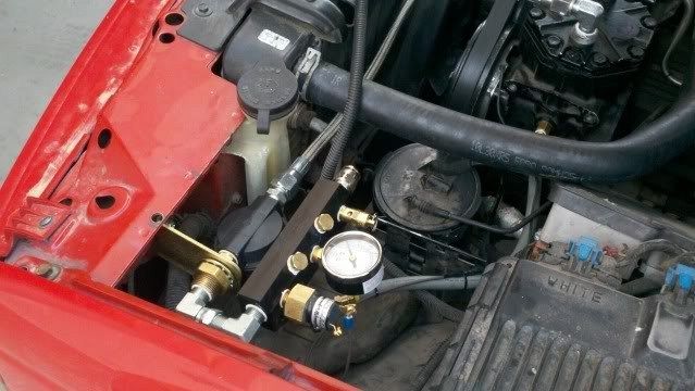

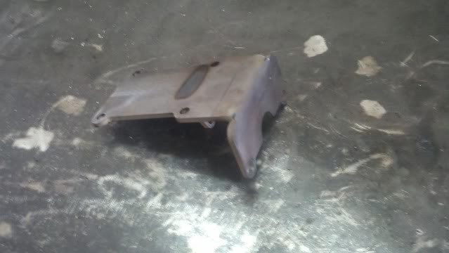

I just did a york 210 on a 454 chevy. I am offering the brackets for sale if anyone is interested. I ran a Kilby manifold and oil separator. Fills 18 gallons pretty darn quick. Also, instead of buying expensive fittings, I pulled the head off and tapped the ports with a 3/8" NPT. Saves a couple pennies and looks better IMO. I also bent up a piece of hardline off the suction to a filter.
