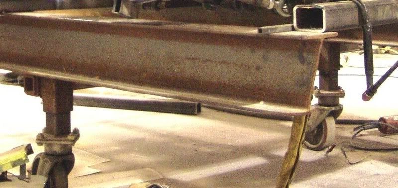

I am building one currently, looks like the 6 legger on the front page, but is 12x4. I am looking for 6 trailer jacks right now because you can level it with skid feet or put on wheels to roll it around. I dunno though, the cheapest I found trailer jacks is 16 each and thats a hundred bucks in levels, might have to do adjustable feet.

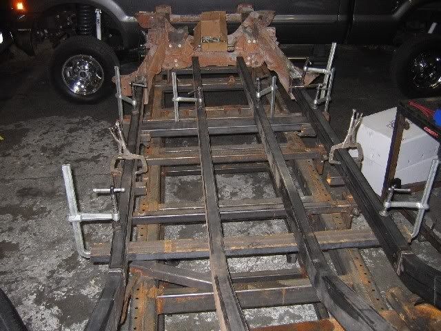

heres mine. I have just over 100$ into mine. Its obviously not as large as everyone elses, its just bassicly set up to hold the track width and legnth of a S-10 pickup.
It worked very well for what i was doing. Made adjustable legnth legs, and when im done with it, its small enough that i can hang it above my rafters in my shed, and bring it back out if i ever need it again

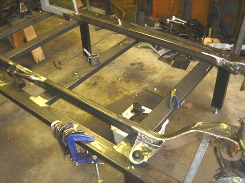

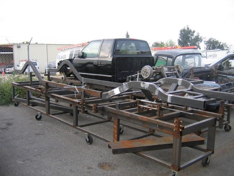

Here's the one I built...
Was that before or after I drew it up in CAD, made a cut list, and tacked it together?
granth
that looks really good. just enough to work on..
