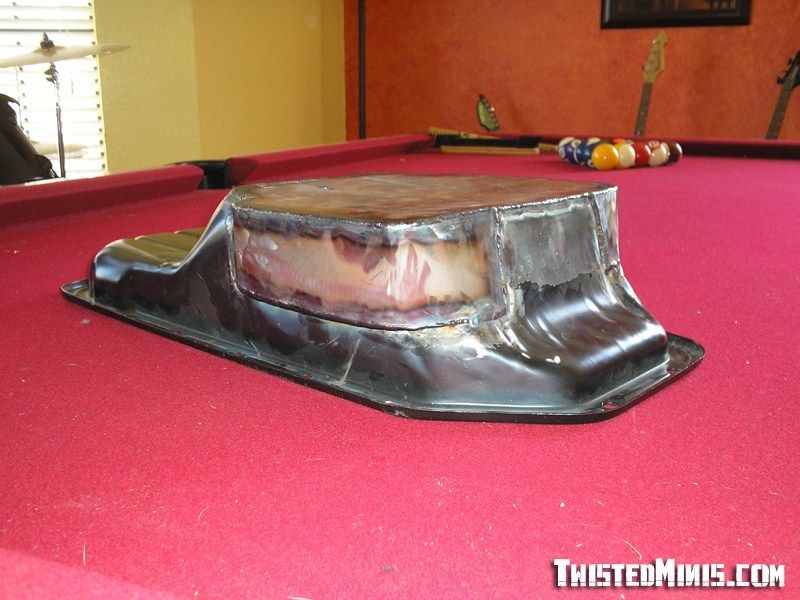

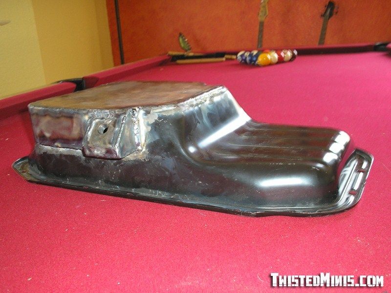

Depends how much you lower it. I lowered a friends motor, and the pan is a cunt hair off the ground. Depends how much the crossmember is drug as well. But sectioning the pan isnt that hard. I did this one and kept stock oil capacity.

You should be able to drop your motor an inch without it hitting the steering. My motor is essentially dropped 1.25" and theres about 1/8" of room between the two. For the crossmember, you can notch out the center of it where the pan is and plate it, because the pan sits about 3/4" away from the crossmember. All you really need is 1/8" of space or so so they don't rub.

so i need your engine mounts and to section the oil pan and nothing else should hit.
