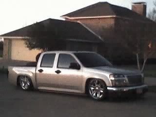

Let's see if this pic works.

i was the one that bagged the CANLAY20s...narrowed rear end even w a high offset 20s, fuel cell, new driveshaft tunnel, all new crossmembers including tranny, shortened lower a-arms, custom made uppers that are raised. But u dont have to tub the firewall for 20s and probably not for 22s but cant lay his front on the frame but its on the lower a arm crossmember since it was the lifted 2wd package and it will hit the oil pan. Hope that helps

If you want to see what Nate is talking about what we started with, here's a pic of it right before I took it to the shop. This ain't no photoshop.
