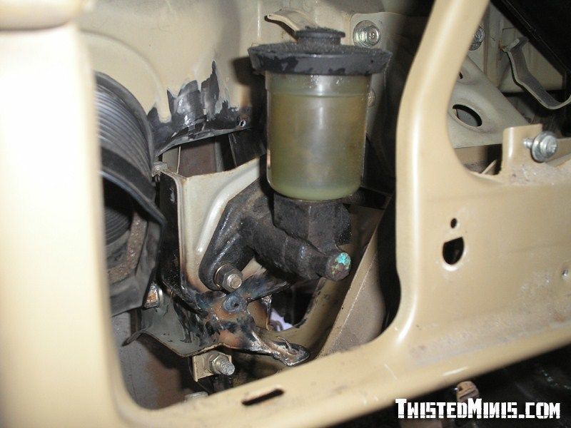

TwistedMinis's avatar
TwistedMinis
I put mine under the dash, there was no way it would have fit in the engine bay.
Its now got a short throw, and easier to depress.

doordraggintaco
YES IT WORKS,SEE HOW MUCH SMALLER SETHS CYL IS?IT LOOKS EVEN SMALLER THAN THE 86 BODY STYLE.THE CYLINDER IS LONGER ON THE BACK ON THE OLDER ONES SO MOST OF IT STICKS THRU THE FIREWALL BEHIND THE DASH INSTEAD OF OUT OVER YOUR TIRE.
TwistedMinis
Thats the stock one from my truck. My booster is also smaller than on the new trucks, its a cunt hair over 8" diameter.

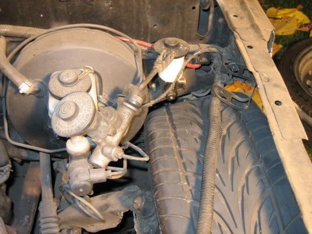

ford04focus's avatar
ford04focus
i swapped it out friday for a new one from a 86 and it helped alot i dont think i have to move it up at all it tucks all the way in now but i may have to swap the booster now because it almost touches
smctoy's avatar
smctoy
hey when you get a sec...post some pics of what you did!!

tenagator's avatar
tenagator
i used a honda civc reservoir. put it in the wiper cowl. ran the hose down thru under the dash. there was no room to keep it in my case.
i also moved the brake booster over bout 2 inches.
looks like ur in need of new upper contol arms? unsure but the pic looks as if there cut up? can be dangerous if so?!?!?
