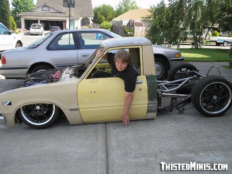

do you have any pics what it looks like now
About like this:
Only picture I really have from the side. Thats after I rolled it and welded up the sides I cut slits in, and ground it down.
W
watatoy
cool thanks man

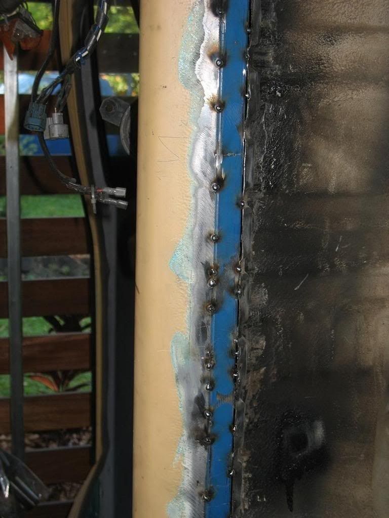

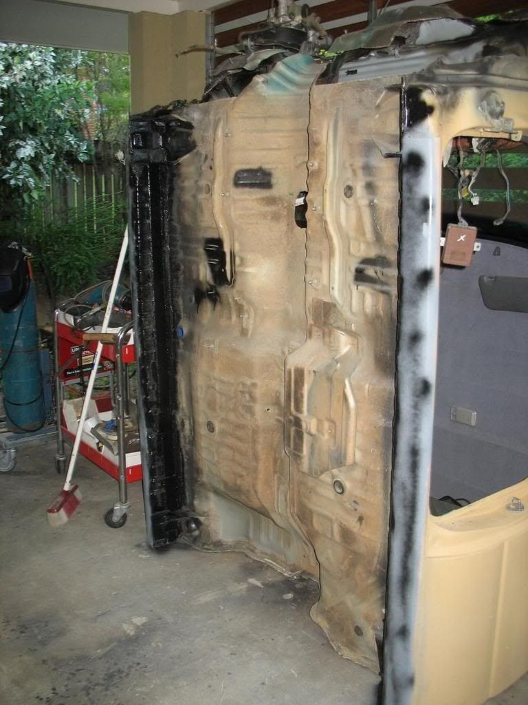

Z
zac
i cut my rocker 25mm or one inch from the bottom of pinch. i then welded in some box tube so when i laid it out or dragged it hit was dragging on 3mm tube which is like 1/8" thick i guess. we talk metric in australiaanyway pics can do the talking
