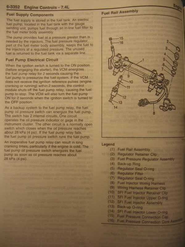

make sure your coolant sensor is connected and you have coolant in the engine.
control module energizes fuel pump relay for 2 seconds at start up to build pressure,
then control module checks coolant sensor and tp sensor to determine the correct air fuel ratio.
also the pickup could have fell off on the fuel pump.
my bet is on the fuel pump still, very common prob with all gm vans,trucks.
