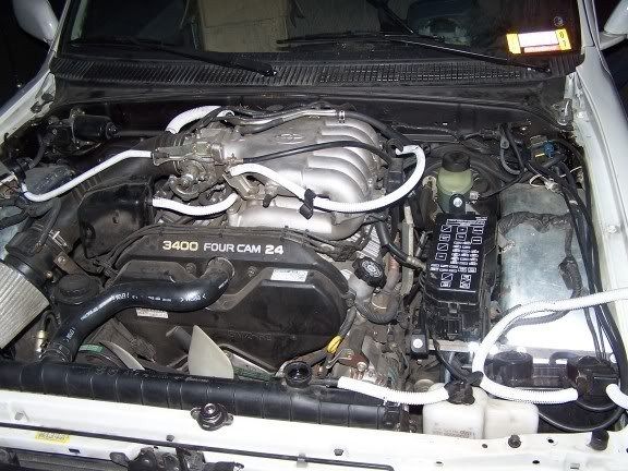

look at my post of clearing a stock hood with a v-6.... if I pulled it off then you should have no problem
factory oil pan not touched, and fatory motor mounts(not touched)
