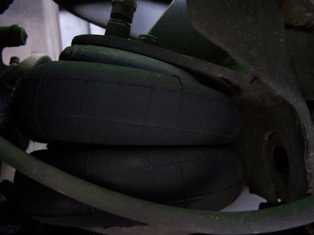

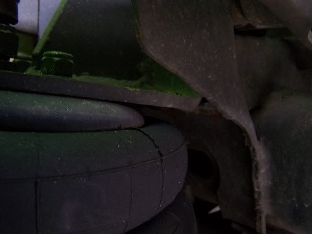

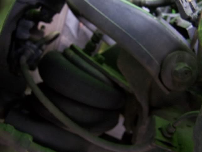

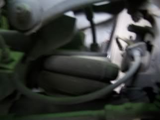

here are some of the first pictures of destruction.... just stuck the camera behind the wheel and snapped what ever was in front of the camera...

Ok, I checked them out. The old installer did not have enough gusset going from the bag mount to the frame, But it is easily repairable. It looks like he barely had the mounts welded to the truck anyway. Just grind the frame smooth, hammer and weld up any holes, and make your new upper arm mounts, and install them and new bag mounts. Make sure your bag mount is wide enough that you can run gussets downward as well, and make them go all the way down the frame if possible. Any questions?
W
waylowwhitey
Yup. Make sure that any of the mounts going to the motor are reinforced, and cut the whole old mount off. Weld in a new arm mount plate, then new bag brackets. If the other side looks like that one, go ahead and fix it before it breaks.

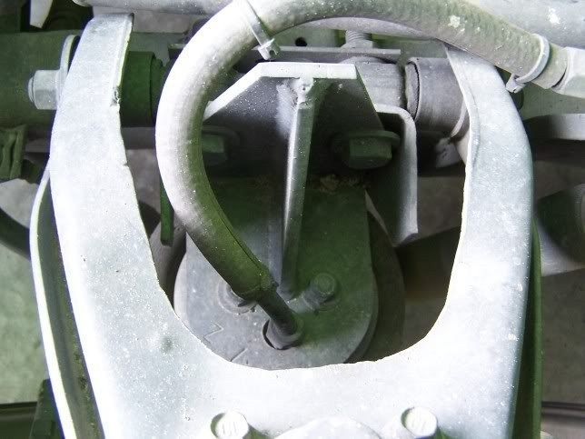

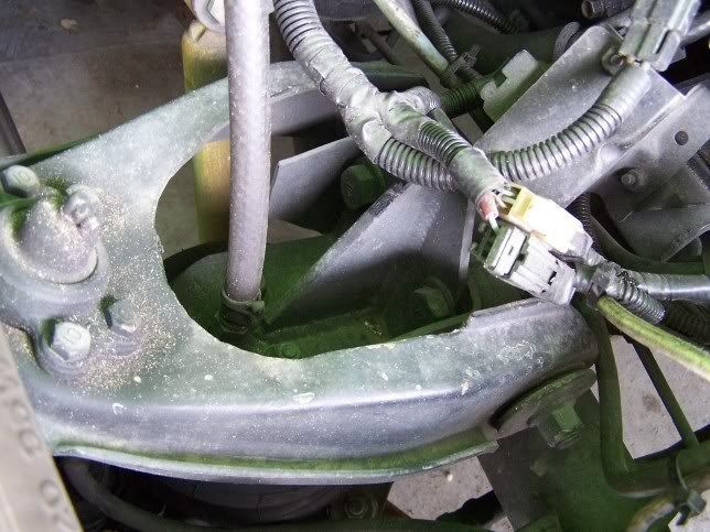

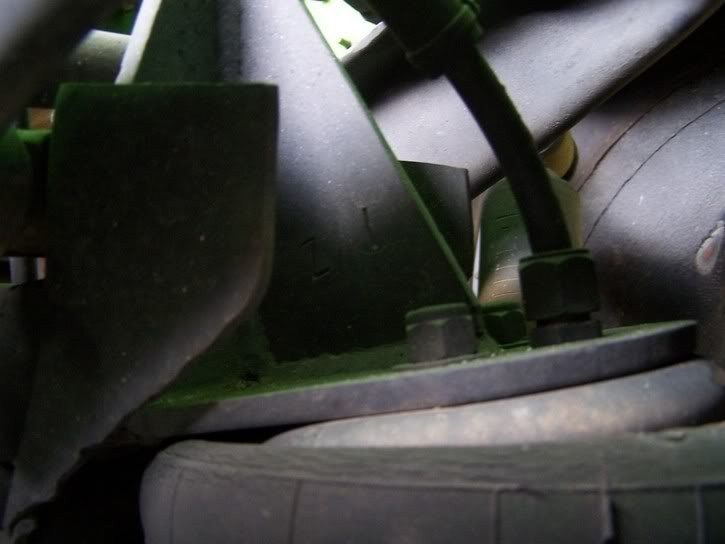

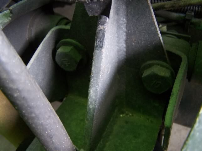

Rigo's avatar
Rigo
Nick here's what my lady's upper mounts look like...
post photo post photo post photo post photo post photo post photo post photo post photo post photo
sicpupidaho's avatar
sicpupidaho
^^^did you gusset the back because it will bend back.
