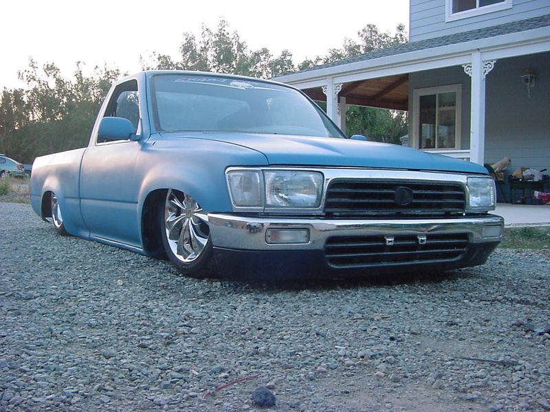

STOCK FLOORED 4 1/4" WITH THE STOCK HOOD
streetsweeper1
Here's a pic of the stock floor

Ahh...Thanks for the pic! Do you know how he did it? I had to section my oilpan.
Yea I know how it was done, he's a good friend of mine. The oil pan was shortened a bunch and he had to mess with his steering arm because the pan was hittin that to.
My yota is only BD 2.5 inches and i got a stock hood. I alos Z'ed my frame so it layed the rails flat. All i did on my motor was lower the mounts on the frame an inch and cut the oil pan down a 1/4 inch to keep it off the ground.
