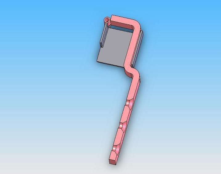

well i just did a new drawing in solidworks to test out my theory of a bigger hinge = longer swing and i was right, if your hinge pocket is made out of 2x3 then your hinge will swing out 3" where as a 2x4 will swing out 4" and this could be pretty helpful if you need to cleare a stupidly designed door jamb like ours. I guess its just lots and lots of measuring.
Low_SST's avatar
Low_SST

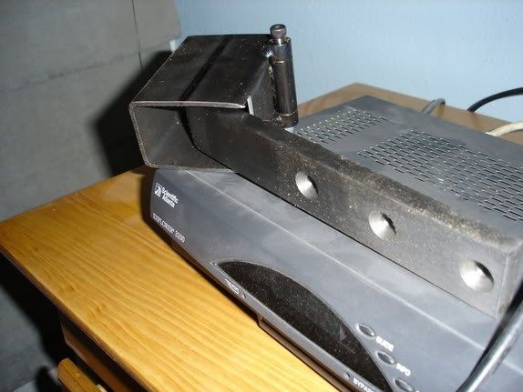

These are some hinges i desiged that would bump the mount out further but still get the same distance of swing, its just that the door would be an inch foreward when fully open when compared to typical hinges.
and section view

you can make that by getting some material thats the same as your arm part of the hinge and then cutting it and welding this piece in place and metal finishing it.
