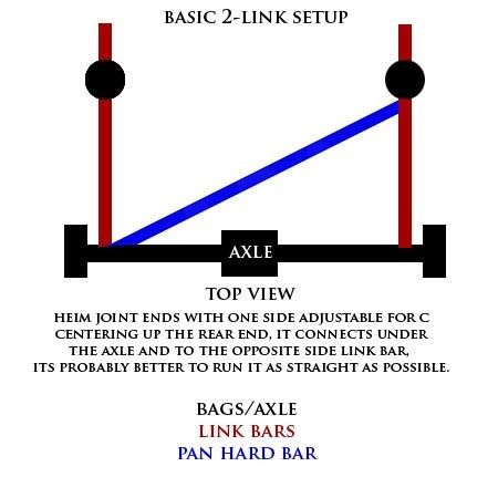

here is a basic 2 link setup, they are simple and easy to adjust, not a lot of side motion though, good luck,

this is how they work... You set your pinion at ride height and its ok but any change and its fucked. i havent seen a "proper" one yet so im biased i guess.

i have a 2link with a trac-bar and so does a good friend of mine they came from if customs and im sure they know wat they are doing
