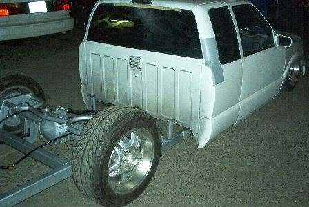

first off have you ever bagged a truck or did any minor frame work...or can you weld not trying to be a smart ass just wondering
SCLUSIVE's avatar
SCLUSIVE
No Its Cool But Yeah.. I learned Welding For My Senior Project In High School And Worked Under The Wing Of A Proffessional For Awhile. I Did All The Work On My Truck Plus Ive Done The Welding/ Frame Work On A Few Others. Welding Not A Problem Though!
HIonPsI
use 188.wall thats what i used before you start hackin it up make sure to measure evreything and have a exact measurements of your frame before you built it.A friend of mine help me design mine on a cad program.check out my profile for my pics
bagged86's avatar
bagged86
I didn't do a full frame for the reasons stated above (steering and suspension geometry), instead i built a fixture so to speak that kept the original frame square, then cut the frame off directly behind the control arm mounts set the new frame in, to a few measurements and started to tie it all together. I used 2x3x3/16" worked great, should be strong enough for a mini. If your gonna do a full frame your probably gonna spend just as much to make a frame table than steel for your frame. Check out Wayne Messbarger's profile, sure did help me.

Hey Thanks For The Info Guys.. Finally Gettin Somewhere! I Actually think I'll Be cuttin it ridrectly behind the control arms as well. I'm A Mechanical Engineer @ The University of Portland, so I have access to Auto CADD and all its renderin programs. Im Gonna Draw it up on Auto CADD Before I Do Anything, thats how i do all my projects..

dragginbagged is wayne, but the pics I was thinkin of are on Russ-D's account, but you should check out both of em, remember to measure everything you can think of and make sure its square before and during welding. Later
