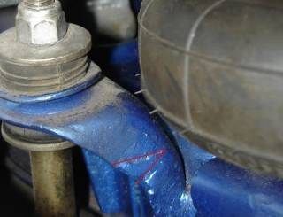

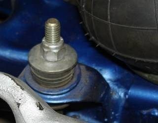

here is a pic with the truck dumped. I first made a cut in the stock mount like the red lines indicate. I then bent the mount down to close the gap and welded it back up. I also am still using the stock sway bar end links with no binding:And here is a pic lifted:

thanks ryan,i appreciate that , that's what i did also (the first time) but i think i had my bag closer (inward). and my bag was rubbing on it and the rod did'nt look to happy when i was aired up. i think i was een bending rods.anhway i had issues but was determined to have a sway bar.
your's cool though.
