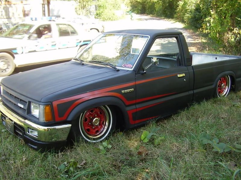

i dont know much bout mazda`s either but i do know that they do not have control arms the have torsions which suicide doors sells a kit to bag the front and to do the 5 lug conversion there was just a artical about that in the nov. minitruckin and they said to get a toyota rear i think 84 to 89 i think obviosly you dont know what a control arm is...they do sell lower control arms,but if your baggin it i wouldnt use them,the bags will rub on them.there is very limited space on a mazda.the best way to do the front i think is to start with a naked frame and go from there,thats what i did,and for the 20's,im not sure but i think u have to tub the firewall,but im layin frame on stock wheels and stock tires(26 inches of tire to be exact)its real tight in there,but all i did in front was flipped the balljoints and notched the factory controll arm...lays out pretty good to me!
