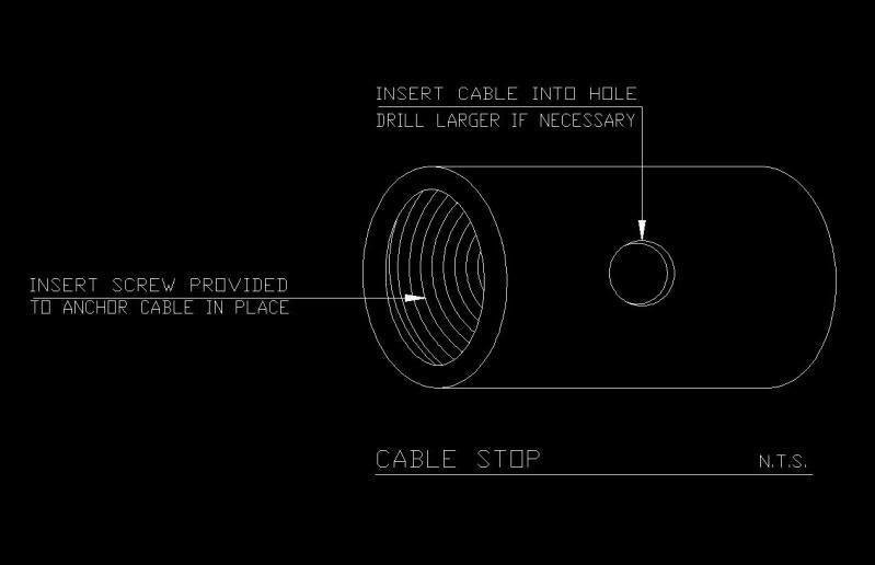

in addition to what quinn (m i zombie)said, if you dont have the tap and die set, you can buy whats called cable ties / cable stops. its the same thing quinn made. they come in a little "help" package with varying sizes. they worked really good when i used them to fix the interior door latch on my ranger... apparently ford doesn't just sell the cable. haha. just get a universal cable and even if you have to cut one end down to size.
holcombe347's avatar
holcombe347
because i needed 10 minutes to fill, i drew you this picture of a cable stop... haha.

glad to see that you found them. but yeah, just grab those up and get the cable you need to and cut it to size and put those cable stops in.
