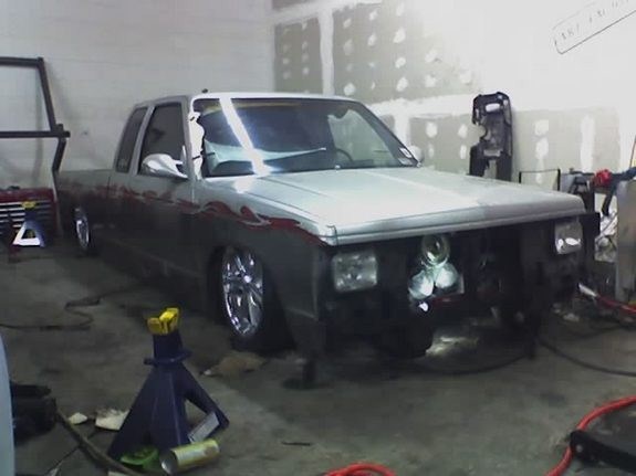

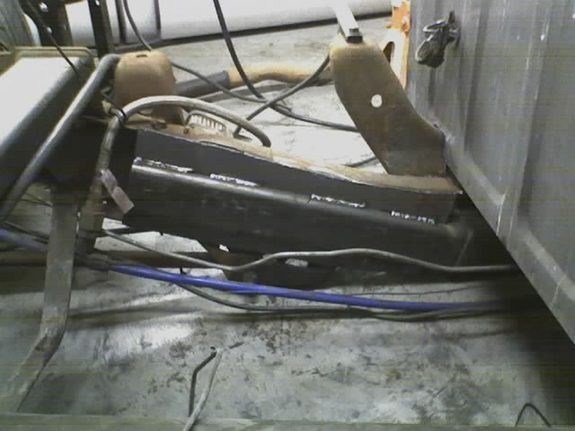

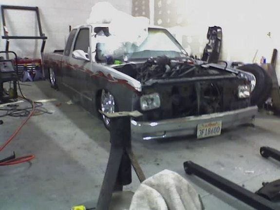

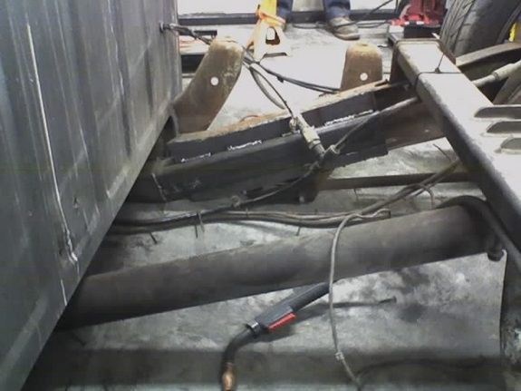

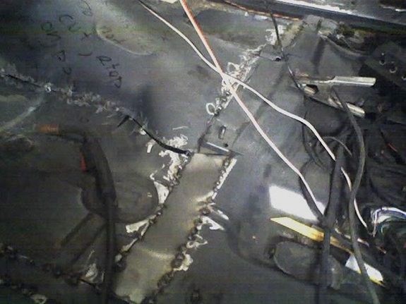

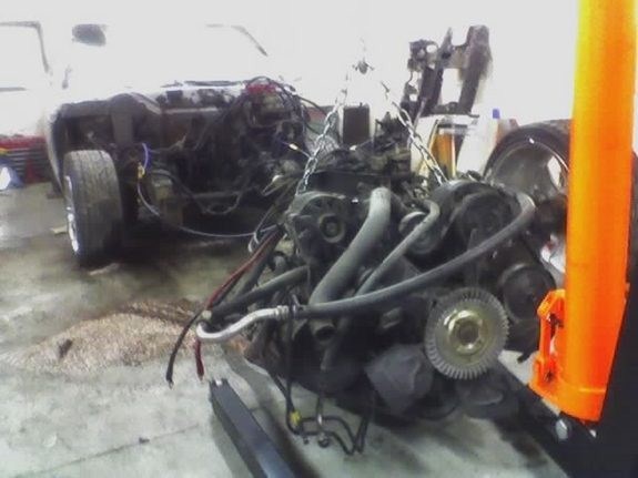

We sectioned the engine crossmember, lowered the motor mounts and notched the oil pan for the tierods. Thats it, least all i can think of off the top of my head.
There was a min there where it still didnt look like it was going to clear but glad to see it does and the front ends back together!

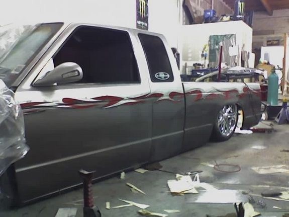

look what I got for X-mass, a Body dropped truck!!
