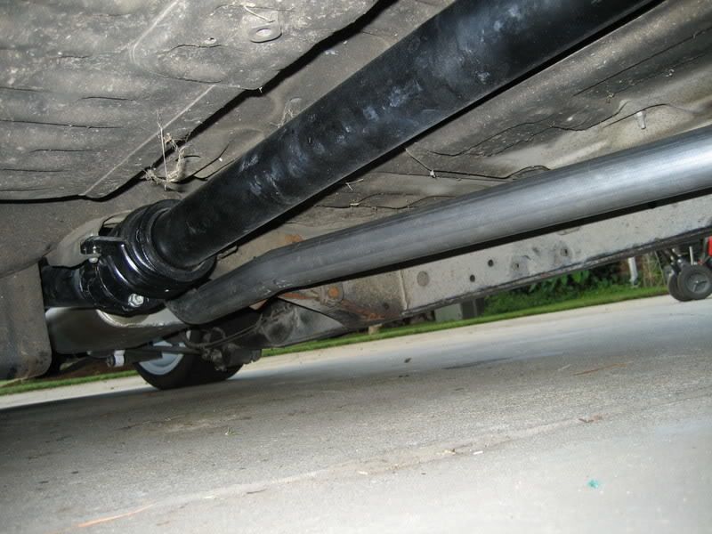

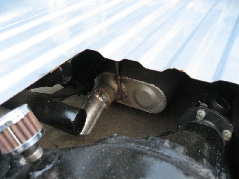

No exhaust shop I went to could make a tigh enough bend to do what I wanted. So I decided to try myself, I picked up 2 mandrel j bends with the tightest radius I could find, and did this... I was originally going to try and tuck it out through the bedside but went a different route. Sorry for the nasty pics. Truck has been down for a while as you can tell. I need to get a hanger on the exhaust and wrap the whole back pipe in header wrap.
How it looks outside (3 inch polished tip)
