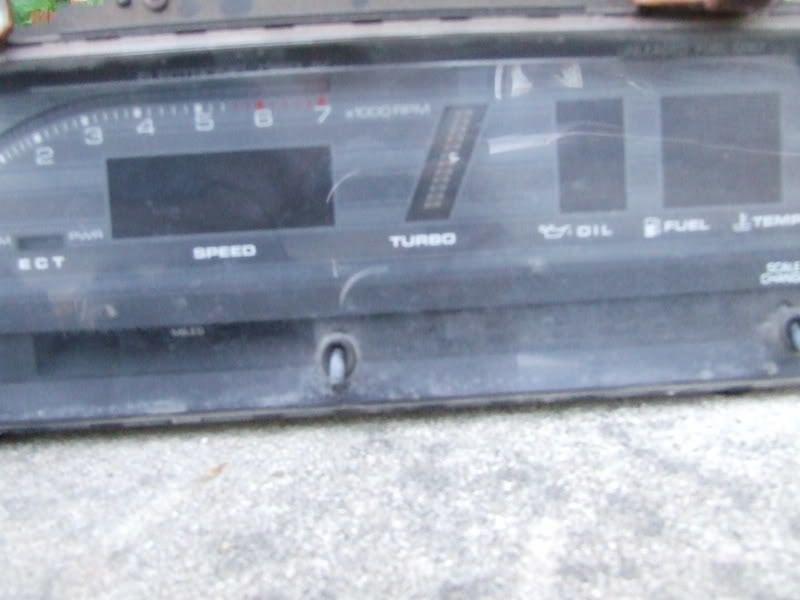

oldsklminitrk
get one like that factory option in the 84-88
2thpic's avatar
2thpic
whoooo, thats looks very different. is that out of a diesel style mini?
nigels_world's avatar
nigels_world
With a redline of 5500 it definitely did not come out of a diesel truck. I would assume its from a 22rte truck.
