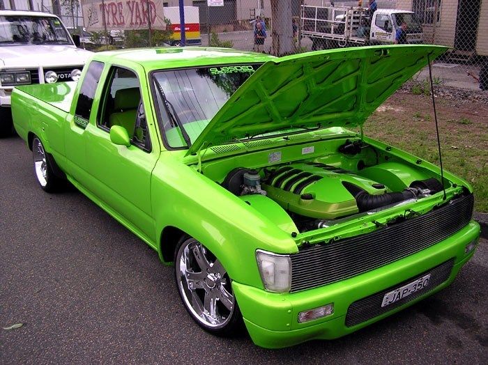

anybody know where to get any kind of v8 mounts for a yota?i am leaning towards a LS1 if anyone makes mounts

Hit this guy up....green350lux is his ssm name. hes got an ls1 in a yota!

What year Toy is that, & is that a nonexport model( lic plate)
