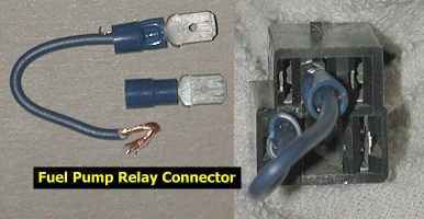

1time's avatar
1time
Yeah make a jumper as suggested similiar to this....
but put a fuse on it to be safe.
