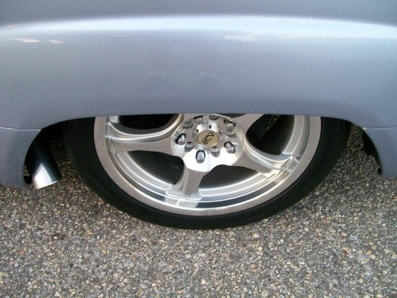

toyotaman89
smack it around, flip it, and pop that SOB out in front of the tire!! Muaaaa ha ha ha ha!
macdave06
dump it in front of the rear tire. you wont need much in the way of bends.
