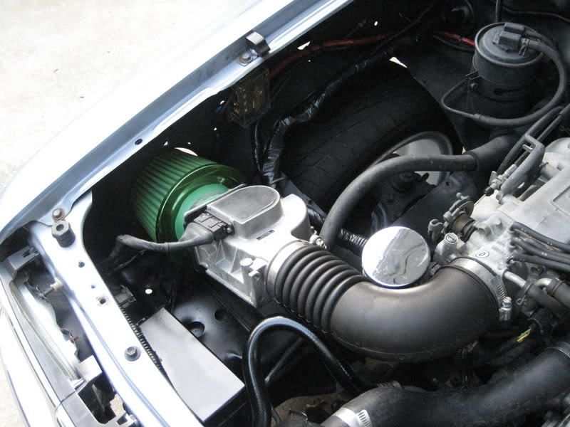

smctoy's avatar
smctoy
Its not the best pic, but you can see where I relocated mine & its nice & safe!! Hell it was one of the easiest things to move lol!
