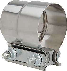

what about clamps? Their cheap and easy. cut the old out and clamp the new in or if you dont have to worry about emissions just find a piece of pipe to replace it with.
rusty13
what kinda clamps? and yes,emmissions is the whole problem. I live 3mins from a town that doesn't require them,but mine does.
rusty13
Son of a bitch,i Didn't even know such things exist. Well,i officially feel stupid.
