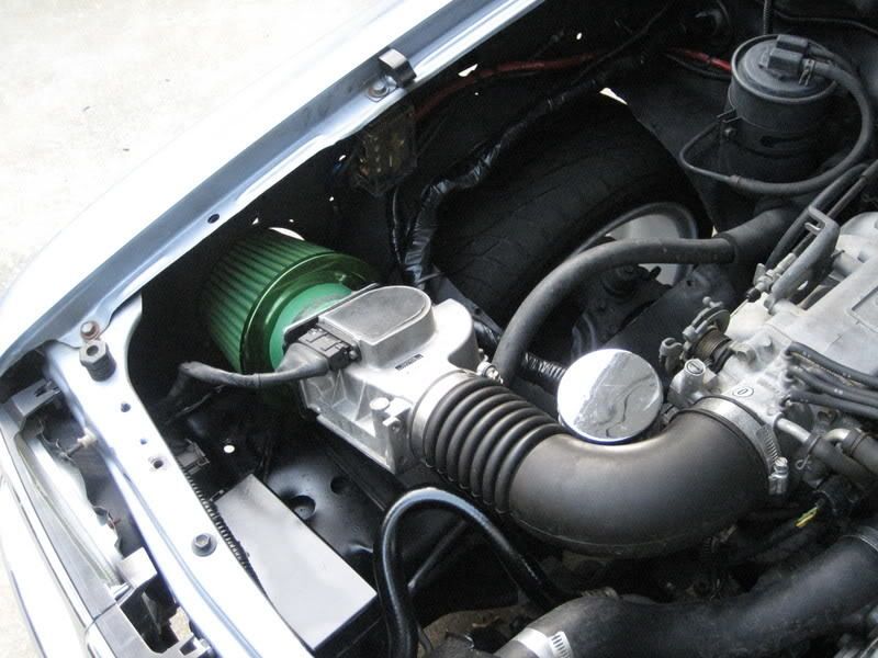

You may be able to buy the intake adapter kit from a parts store or you can always get a intake kit off ebay. I pretty much made my intake..all I did was buy the filter adapter kit & used the factory tube, but Im about to have a tube cut to replace that. Here is what Ive got & not too worry, it doesnt affect any sensors.

soo all i have to get is the intake cone and put it at the end of the intake on the other side of the radiator?
i see some kind of sensor on the intake box

make sure the air flow meter is hooked up and thats it. the plug you see going into the box behind the filter just goes into the air flow meter and gets its fuel mixture info from there.

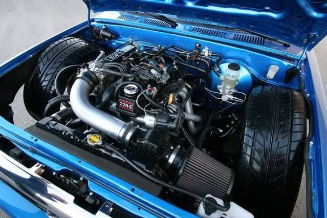

i have the same set up as SMCToy however i have mine routed stright down from the throttle body because my tires were kicking up to much water and i feared my intake was going to suck it in. I have it resting on the top of my A frame.
