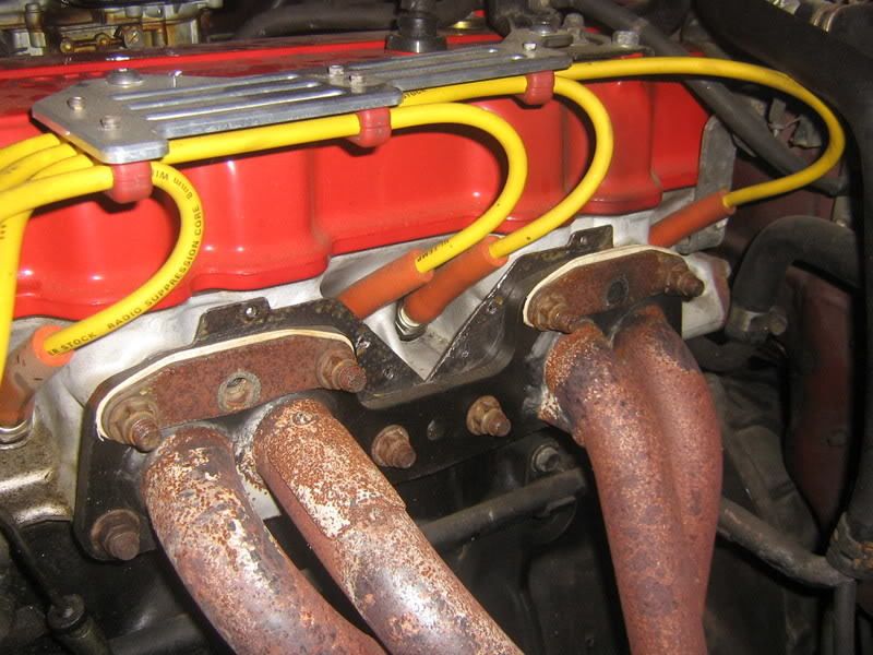

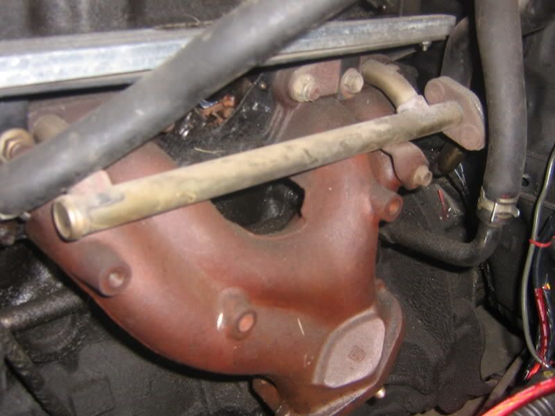

hey guys i need to find out what this gold pipe is for and how to get rid of it? its the pipe just above the header. the first pic is of my motor and the second is a pic of a buddies, that dont have that pipe.

goes to the big valve thing under your intake. your buddy's engine has a header and yours has a manifold. call LC Engineering tomorrow morning. 1-877-505-2501. Toll free. call em. get a f'n header damnit. you'll thank me.

so just buy a header and thats it? what about the other end of the hose that connects to it? i pland on gettin a header from doug thorley with income tax.

perhaps a block off plate? to be perfectly honest, i kept all that crap because i'm using the stock injection so my piece will be reliable.

I think it's only on the EFI engines, & you should keep it as it directs hot air to the cold start valve & more!!

I have a carb and that pipe tied into the EGR system.

Pipe goes to the EGR you dont really need it unless you live in a smog state, You could make some block off plates or get a header not all headers will block it off though, I have a Thorley Header with a LC metal exhaust manifold gasket

that pipe is for smog but I live in Mass and I take it off every 4 cyl toyota I have had and have passed the sniffer for years ..and still now.. the quickest and easiest way to get rid of it is to cut close to the manifold pinch the tube and weld it up thangrind it smooth and put it back on... then dsconnect all the crap it conects to all thway around to the airbox and plug the large tube coming off the airbox...

That may be true but you would fail the visual inspection if no EGR valve and related parts are missing

visual inspection? make it look clean so unless your a toy man you wouldnt notice it was gone................................
